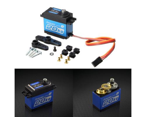

Bericht door Subonno » 05 dec 2018 11:49
Mag ik even inhaken op dit topic?
Ik kwam gisteren op een Duitse site met speelgoed ;-)
Ik heb een Power HD LW-20MG (blauw)gekocht met nog een paar dingen voor mijn ECX Barrage:
Specs;
Description:
Torque(4.8V): 16.5 kg-cm (229.1 oz/in)
Torque(6.6V): 20.0 kg-cm (277.7 oz/in)
Speed: 0.18 sec (4.8V) │ 0.16 sec (6.6V)
Operating Voltage: 4.8 ~ 6.6 DC Volts
Weight: 60 g (2.12 oz)
Bearing Type: Ball Bearing x 2
Motor Type: DC Motor
Gear Type: Copper & Aluminum
Operating Temperature:-20℃~60℃
Working frequence: 1520μs / 333hz
Approx.Size: 40.7 x 20.5 x 39.5 mm ( 1.60 x 0.80 x 1.55 in)
Dit zijn de specs van mijn ECX Barrage:
(1) ECX 2.4GHz Transmitter
(1) ECX 2.4GHz 2-CH V3 Receiver
(1) 100mAh NiMH Wall Charger with EC3™ Connector
(1) Dynamite® Speedpack® 900mAh NiMH Battery with EC3 Connector
(1) Dynamite Tazer™ 390 Brushed Motor
(1) Dynamite 60A WP FWD/REV Brushed ESC
(1) Spektrum™ S602 digital servo
Specs van de ESC:
Type: Waterproof 60A Brushed ESC
Forward: Yes
Reverse: Yes
Brake: Yes
Time Delay Brake: Yes
Crawler Mode: Yes
Auto Cutoff: Yes
Overload Protection: Yes
Low-Voltage Cutoff Programmable: Yes
Continuous Current: FWD: 60A REV: 30A
Maximum Burst Current: FWD: 360A REV: 180A
Input Voltage: 2-3S Lipo, 5-9 cells NiMH/NiCd
Motor Limit: 2S Lipo/6cell NiMh >=8T 540/550 closed endbell motors, 3S Lipo/9cell NiMh >=13T 540/550 closed endbell motors
Battery Input Lead: 16AWG, 4.53 in (115mm)
Input Connector Types: EC3
Motor Output Lead: 16AWG, 4.53 in (115mm)
Motor Connector: 3.5mm Tamiya style bullet
Length: 1.48 in (37.5mm)
Width: 1.46 in (37mm) without tabs, 2.23 in (56.6mm) with tabs
Height: 0.71 in (18mm)
Weight: 1.41 oz (40g)
PWM Frequency: 1KHz
Full On Resistance: .0008 ohms
BEC: Yes
BEC Type: Linear
BEC Voltage: 5V
BEC Continous Current: 2A
Speed Control Type: Brushed
Drive Type: Forward/Brake/Reverse
Continuous Maximum Current (will be Amperage): 50 - 75A
Wat moet ik nu precies nakijken of ik deze servo zo kan monteren ja of nee?
